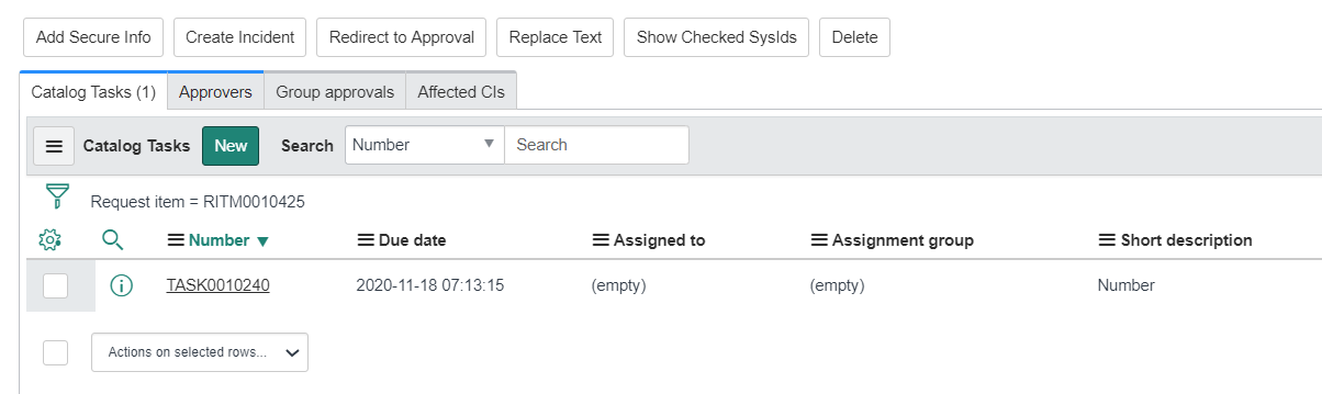

within a Workflow on RITM we create a catalog task via the normal activity.
Beside setting the variables accordingly I need to update the activity stream with the task number created.
I also activated the "wait for completion" .. so I don't nee d the number later - I need it directly with the activity.
Sure I could add a business rule etc. to add it, but I wonder how to do WITHIN the activity.
This way it does not work ... The Text will show up, but not the number ...

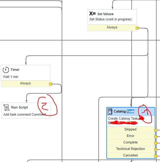

I added workflow.scrachpad.task_number = task.number within the task activity.
Then I added a parallel part, with a wait condition to be sure the scratchpad exists ... then I just used it to add the comment ... 😉
Works 😉

did you try that? what value it gave
Ankur Bawiskar
as per this question it is not possible from what Chuck mentioned
Workflow - Create Task activity - Get task number
Ankur Bawiskar
@Zod
I just tried that and it didn't fetch the number
So the only option is before insert business rule
