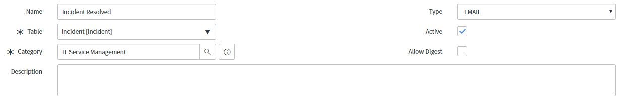

Under System Notification -> Email -> Notifications I'm looking at the OOTB Incident Resolved notification.
And its default condition is to send when Incident State changes to Resolved.
I'd like to add an and condition that checks to see if the incident has any Requests (sc_request) related to it. If it has a request, do not send notification. If it does not have a request, send the notification.
From what I can tell, when I click create request within the incident in the hamburger menu, it sets the incident as parent on the request. Not on the incident.
I unfortunately do not know at this time how to make an advance condition with scripting. Also when showing related fields, I did not see anything related to the request table.
Any help would be appreciated!
Thanks!
Dom
