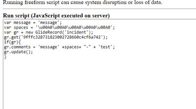

Hi @Puneet4418 ,
Since you are dealing with a formatter field in ServiceNow, regular spaces or HTML entities may not work as expected. Instead, you can use a Unicode character for a non-breaking space or a different approach to ensure the spaces are visible. Here's a revised approach using Unicode non-breaking spaces:
var spaces = '\u00A0\u00A0\u00A0\u00A0\u00A0'; // 5 non-breaking spaces
gr.comments = msg.getValue('message').toString() + spaces + '-' + test;
If you need a longer space, you can adjust the number of \u00A0 accordingly. Alternatively, you can use a different Unicode character that provides a wider space, such as the em space (\u2003), which is wider than a regular space
You can repeat the em space character to achieve the desired length:var wideSpaces = '\u2003\u2003\u2003\u2003\u2003'; // 5 em spaces
gr.comments = msg.getValue('message').toString() + wideSpaces + '-' + test;
Using these Unicode characters should ensure that the spaces appear correctly in the formatter field in ServiceNow.
I checked it in my PDI and it is working fine
Script -
Result-
