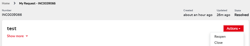

How to add the dropdown 'Escalate' in the Actions button of incident in portal ?
Thej1
HI,

HI,

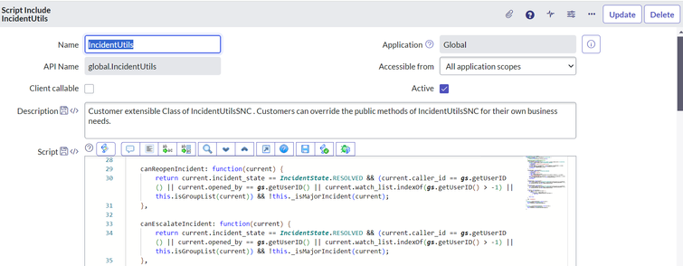

I did the changes as you said and also added in the script include 'IncidentUtils'. but still it is not working.
Please find the below screenshot.

The code you've shown above looks fine provided you wanted the Escalate action to appear in the same scenarios as Reopen
I missed out a bit of code that needed modifying above. Have you made the changes to the snippet below as well?
This would prevent the action appearing as data.canEscalate(making the assumption on the name) needs to be true for the option to appear
HI,
I missed a line in client controller. Added and now it i working.
