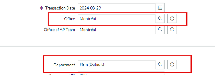

i have an issue where i am trying to apply dual fitlers onto a reference fields on a custom table.
the two reference fields are
Office -> cmn_location table
Department -> cmn_department table
the third field i need to filter base on the office + department
This third field is a reference to a custom table called u_gl_codes and the columns in this table (Office and Department) is also link to the cmn_location for Office and cmn_department for department
I need to be able to filter out the list when users select the office on the table and department to see only the filter of the Gl Codes
