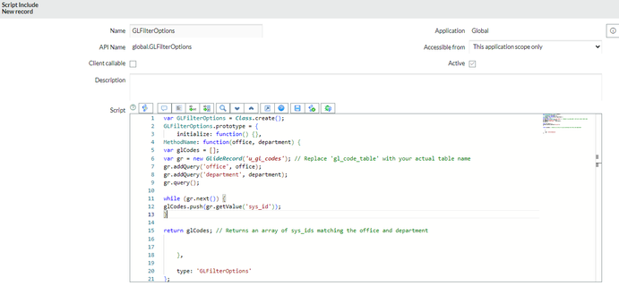

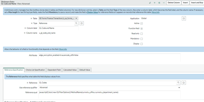

09-13-2024 05:16 AM
ya its not working, i change the table name and adjusted the current.office and current.department names to the correct ones and still its not filting

Can you elaborate and add some screenshots where you are facing the issue?
Sushma.
