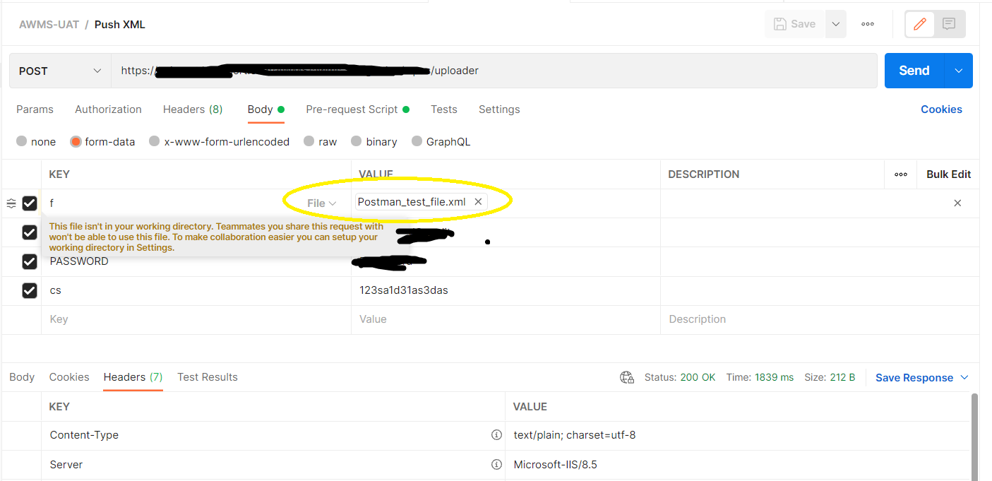

I'm having trouble to call a 3rd party REST API. I have to call that API with the request
1. Header: Content-Type = multipart/form-data; boundary=xxxx
2. A file must be attached as a part of the request body
I tested the sample call in Postman, and it works well.

Yes, using multi-part form data to call REST API via RESTMessageV2 is okay if you don't need to attach a file to the request.
My pain point here is I have to call that API with an XML file attached. I tried calling that API in JSON format and that JSON contains the XML string as the value of parameter 'f'. But they told me it was not able to be processed.
They only shared the request sample I attached as the Postman screenshot. You can see the type of the key 'f' is a file.
