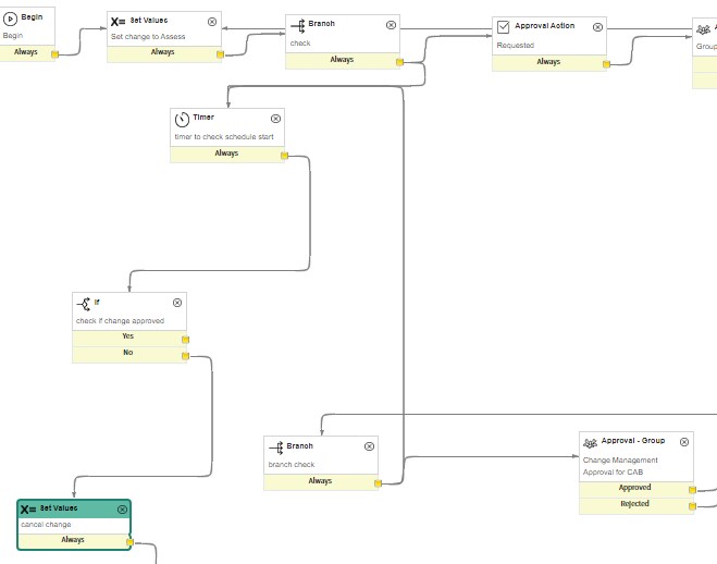

Is there any way to cancel the change and approvals if scheduled starts has passed before approving the change request.

i added if block still it went to approval no and running both timers.
The timer will run always. In both timers,
The if should be after the both timer.
So once timer reached, then check if the change is approved or not. If not, then cancel otherwise do nothing.
is this fine now?and if approved should i leave as it is only no connection with any activity?
Looks good. You kept same IF after 2nd timer also right.

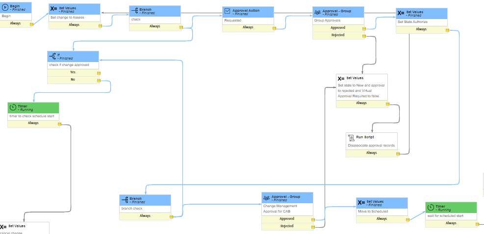

worked little fine but there is a catch here.
there are two approvals.
after first approval i am marking approval as approved and checking in if block if approval is approved or not.if i approved first approval then validation is successful and it is not canceling the change but if second approval i am not approving before scheduled start then it is not canceling the change because in if block i am checking if approved and i am marking it approved after first approval so validation is failing.
