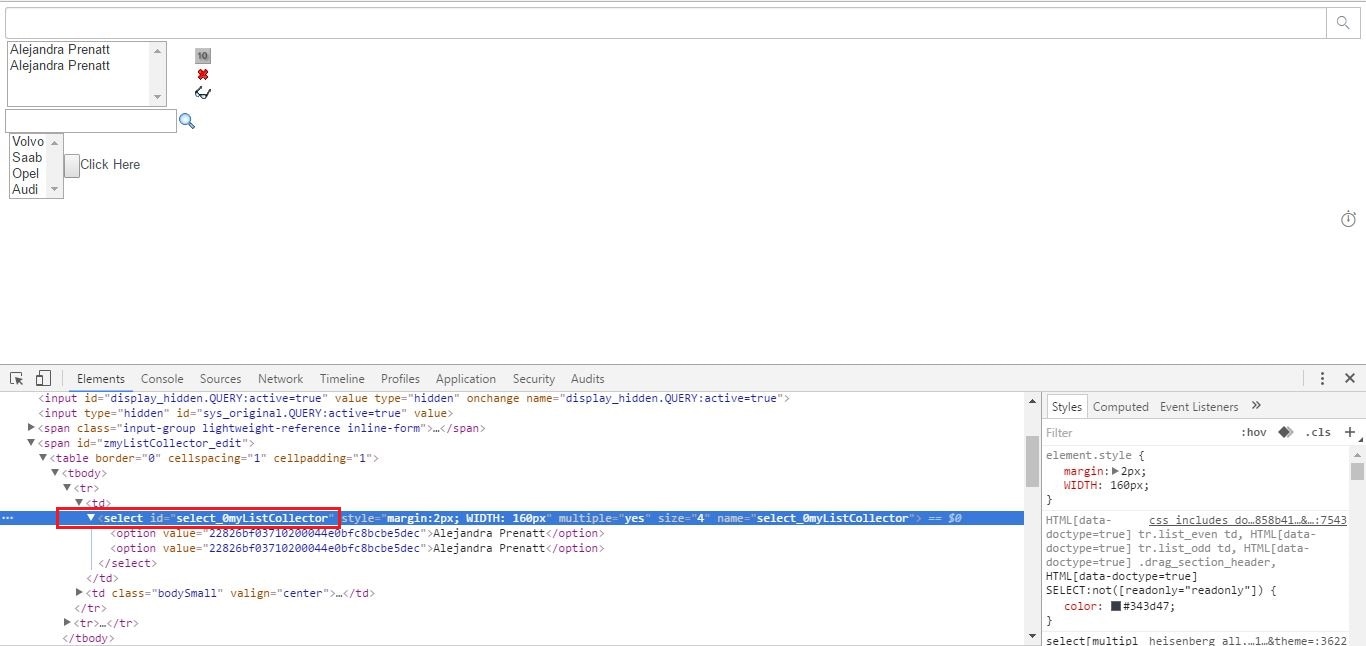

Hi Sandhya,
I didn't get the question. code breaking up when field changed from text to glide list. Are you fetching value of the glide list field in UI page and populating in some backend table. Is this where you are facing an issue?
Following is the script to get value from glide list field in UI Page. It has to be achieved using DOM manipulation
"select_0myListCollector" is the id for <select> tag when i tried the UI page. This could differ in your case. You need to check the id for the select tag
As per the screenshot the id is highlighted in red color
The values which are selected in the glide list are stored as Options under select tag.
Following code will iterate for all options and alert the selected values. You could then store them in an array and process further as per your needs

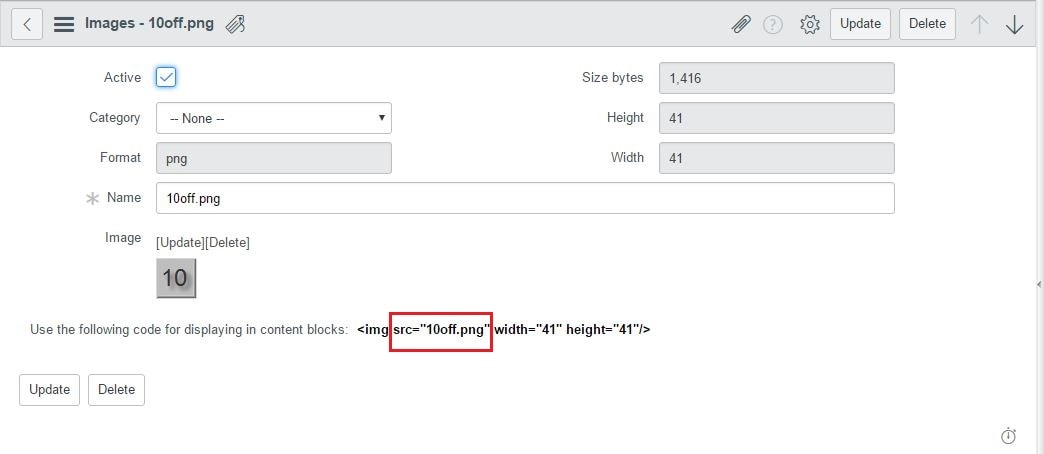

As per your requirement you want to change the icons. So here you go
1) UI Macro "lightweight_glide_list" is out of the box. Don't try to change anything in this UI Macro. Since changes done to this will be a global change
2) Create a new UI Macro with exact same code and rename it to "lightweight_glide_list1". Copy paste the xml section as it is in the new UI Macro. Also update your UI page to invoke this macro now instead of the earlier one.
3) In below screenshot line 44 is used for displaying icons using image tag. You can add your own icons in images.
4) In left nav type images. check whether the icons are present in this table. If yes then as per the screenshot pick up the value for src attribute from image tag and use the same value in line number 44. Replace the code as below
Earlier - <IMG width="16" height="16" alt="${gs.getMessage('Add me')}" title="${gs.getMessage('Add me')}" src="images/icons/user_obj.gifx" border="0"/>
Now - <IMG width="16" height="16" alt="${gs.getMessage('Add me')}" title="${gs.getMessage('Add me')}" src="10off.png" border="0"/>
5) Once you do this you can see the new icon getting replaced in the ui page.
6) If the icons are not present in the images table. you need to download both the icons and then upload them in images tables. Use their src attribute value and then use them in your ui macro
7) As per above code changes we had replaced the icon with 10.png. so the below screenshot displays the new icon on the ui page

Hi Sandhya,

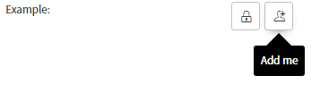

Unfortunately, there's no glidelist macro available using the latest icons. From what I discover, the icons are associated to a specific "class" id.
I am working to build a glidelist macro using bootstrap. It's not complete yet but let me share my findings.
#1 When the glidelist is locked, you have 2 buttons. One is to add yourself and other is to unlock the list collector.
#2 - After you unlock the glidelist, you're able to add/delete a user as you desire.
