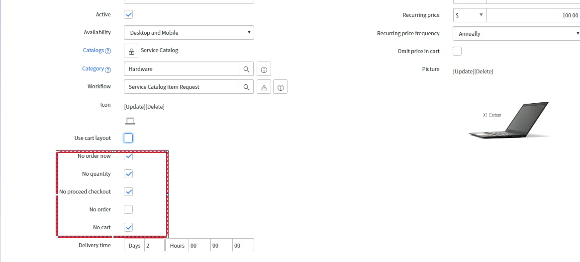

Yeah Rob, That's possible. I have mentioned the way also in the above thread how to do this for one Catalog Item. Please find the steps below:
1) Navigate to "Maintain Items" module under Service Catalog Application Menu and open the desired Catalog Items from which you want to remove these Options:
2) Add the highlighted field "Use Cart Layout" on your form if it is not present on the Maintain Item form by using Configure-->Form Layout as shown below:
3) Uncheck the Checkbox and then you will be able to see the fields like "No Order Now, No Quantity, No Proceed Checkout, No Cart". Check each one of them as required and Save your form as shown below:
If these above highlighted fields are not there on your form then add them using Configure-->Form Layout and then follow step Number 3. This will remove the buttons from only one Catalog Item not from All.

Note: This would be a Global Change for all your Catalog Items. If you want to do it for a single Catalog Item then follow the below steps:
Apply the appropriate solution as per your need.
Hope this helps.Mark the answer as correct/helpful based on impact.

06-17-2017 06:54 AM
Hi Shloke,
Thank you for the quick reply, very helpful.
Will this change affect all forms that use this widget?
Is there a way to have one particular form override the widget so not all forms are affected?
Thank you,
Rob
06-17-2017 07:02 AM
Shloke
