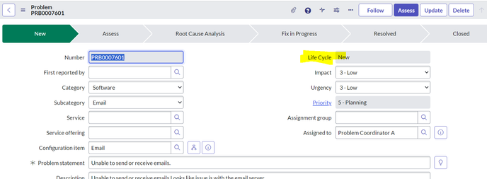

Hello @robertpetrovics
Please create onLoad Client Script on the change table-
function onLoad() {
g_form.setLabelOf('state', 'New Name Of Field');
10-31-2023 03:34 AM
That will only work on form, not on Lists or reports.

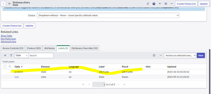

10-31-2023 03:35 AM
Can you tell how you got to this page?
Did you right click on the field and click on configure label or how?
10-31-2023 03:37 AM
It should work...!!
Output :
Can you share screenshot of configure dictionary form on state field ...!! (may be related list)
ServiceNow Developer
- Socrates
