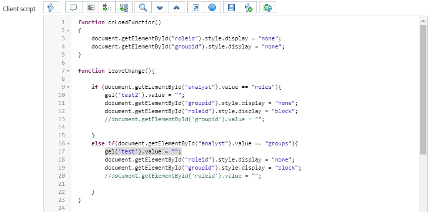

There are 2 dropdown options for admin to select. If the admin select option #2 and type something in reference field search box but changed mind and select option #1, the ui reference field will change but the previous ui reference field still have remaining input value that need to be cleared. If click Option #2 again, it will switch back to first reference field but the old value that admin typed is still there. I have tried use gel('test').value = ""; but it isn't working. Anyone know why?
Here are my sample code,

Try:
document.getElementById('sys_display.test').value = '';
document.getElementById('test').value = '';

Try 'g_form.setValue('your_variable', "")'

I tried g_form.setValue('test', ""); It broke javascript.

Looks like you may need to use the sys_id:

I am not removing any data in table. I just need to clear the left over text on reference textbox that the user have not submit it.
