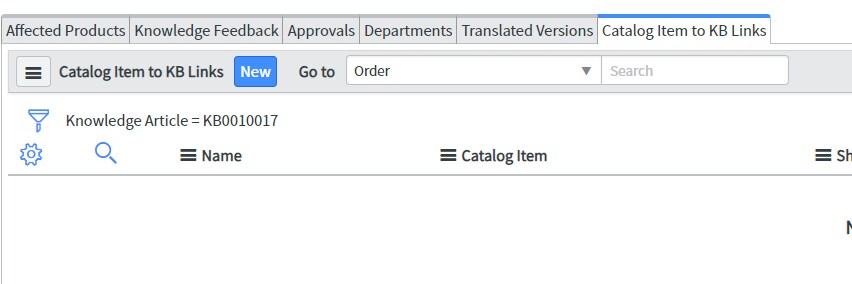

You wouldn't by any chance also use HR? Since with HR there is this functionality already. I have no idea why it's only for HR and not all catalog items. But it gets installed with HR. Then you can have a related list on the article named Catalog Item to KB Link and looks like this:
Then you can create records like this which you then just would have needed to query and show...
I'm going to check with the PO for knowledge why, but I guess it HR that just thought of this functionality and made it. It might show up in the future releases. I would go into your PDI and install HR just to see the functionality and then you can pretty much copy as much as you want until it's there as a Baseline Functionality.

Hello Goran,
I was wondering --- there is a field we can add to the Catalog Item called 'Catalog Item to KB Links '. The table is sc_2_kb.
I have attached a couple of screenshots. Is it possible to use this in a widget? Maybe have a script to query the meta or categories somehow?
