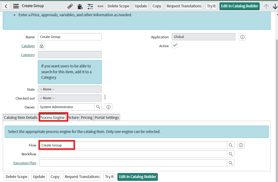

 3. Set Flow to execute when Service Catalog is submitted.
  1. Re-open Service Catalog that was created.
  2. Select "Process Engine" tab and select Flow that was create above. Save the Service Catalog.
