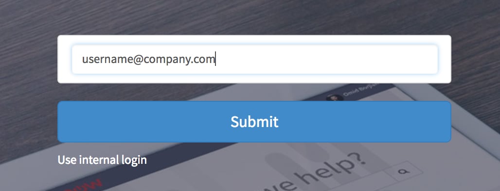

Anyone know how I can change the LOGIN Widget so that the default login is external login?
And the link on the bottom would be Use Internal Login?
I tried changing the HTML code around in the copy of the Login Widget Copy but have not had much success.
Basically I need the Login page to have the default form of External Login and the Link if they want to use internal login.

This is a screenshot of what I am looking to have as the default login page

I'm not sure that it can be done this way since if you are using SSO with the Auto Redirect Idp property turned on, it will automatically take you to the login page of your Idp in order to login. For example, Azure is our Idp and so it redirects to the Microsoft/Office 365 login page when a user navigates to the instance URL. They will sign-in there and be redirected back to SNow. This is of course if they're not already signed in. The instance login page never presents itself.
If it's setup this way, you can append /side_door.do to the end of the URL in order to login at the instance login page.
