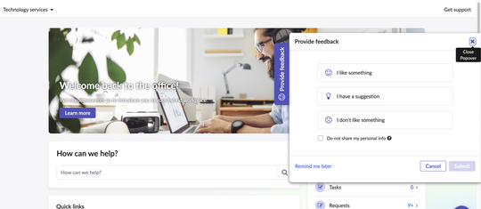

How do i add/enable "Give feedback on Service Portal"

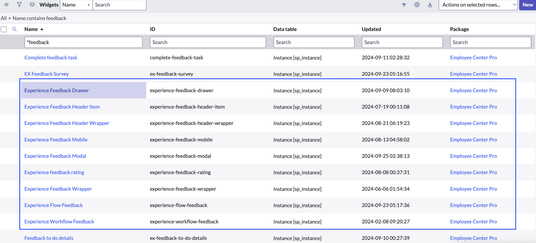

Hi @indrasengupta,
The feedback widget you are referring is Experience Feedback which is available only for Employee Center Pro (plugin : sn_ex_sp_pro). If the employee center pro is installed in your instance then you will see Experience Feedback Drawer widget in widget list. You can clone the widgets related to Experience Feedback and add it on service portal.
