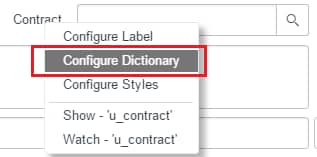

It's easy to configure. You need to go to the dictionary of the Field by right clicking on it and under 'Reference Specification' tab set the Filer condition there. Please find the screenshots below:
I hope this helps.Please mark correct/helpful based on impact

You can do this using a Reference Qualifier: Configure reference qualifiers. A reference qualifier allows you to specify filter conditions that will limit the related records you can put in the reference field to those that meet the condition you specify. If you just want to filter on simple field values (like the ones you specify, active=true, date > today, etc), a Simple reference qualifier will probably work just fine.

System administrators can configure reference qualifiers through the system dictionary.
- Navigate to the reference field on the form you want to edit.
- Right-click the form label and select Configure Dictionary.The Dictionary Entry form opens.
- To change views, select Default view or Advanced view under Related Links.
- Specify the table
- select the type of qualifier in the Use reference qualifier
6. Configure the qualifier: Build the condition that you want to filter
7. Update

Use reference qualifier for this scenario.
