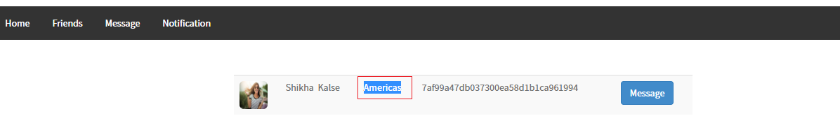

Hi Mark,
Silly one but just for information, can we see if there is any display value for that table, because i was able to get the display value with g_form.getDisplayValue.Check the below ss for the same :-
SS of the alert : -
Omkar Mone.
