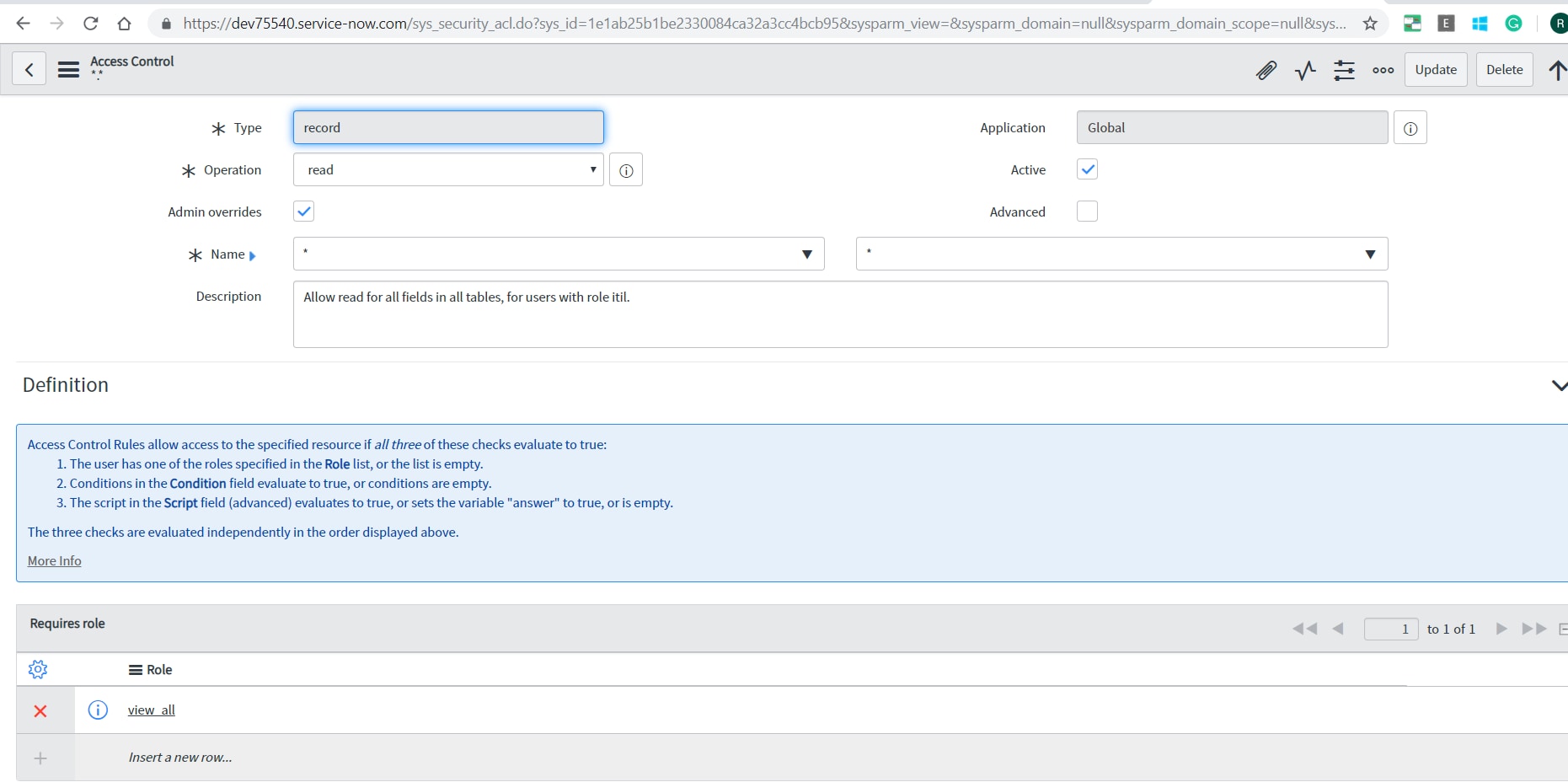

Hi
I created ACL like this below but no luck
Out put
