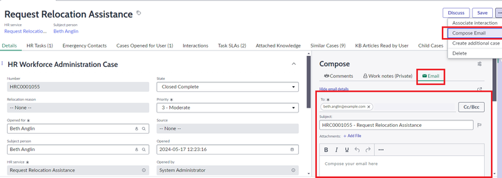

Does anyone know if there is an option to hide the 'Compose Email' in Workspace? The onload script hides the email icon in UI16. I'm looking for a similar implementation to do the same in HR Agent Workspace. In my use case, when the HR case state is 'Closed Complete,' the agent shouldn't be able to send emails.

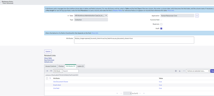

I tried to control it via the email client attribute set to false, but I can't control it conditionally (when the HR Case state changes to 'Closed Complete'). With this attribute, I can only hide compose email when it is set to false.

Hi @Sid_Takali thanks for your reply
Provided solution is for hiding UI Action "Compose email" and this is fine.
But do you know where I can find configuration to hide the Compose email section? It seems like a UI builder component, but I can't find an option to conditionally hide it (when a case is closed).

I don't think you can remove that from record page.
Navigate to the table dictionary for the tables you want to hide it on. Set Email client to false in the attributes.
