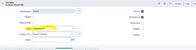

There is one alternative way is to do that without DOM manipulation (not recommended) by Hiding the OOTB attachment icon & add new Attachment variable in catalog item.
You can do UI policy on that attachment variable to hide or show.
10-06-2023 05:05 AM
Indeed thats the variable I was mentioning. Do be aware: DON'T make it mandatory, that would conflict with your UI Policies.
10-06-2023 05:09 AM - edited 10-06-2023 05:11 AM
Thanks for this suggestion...!!
The snapshot captured is from my PDI one....!! can ignore it..!!
Indeed..!! Use UI policy to make it mandatory/non-mandatory.
