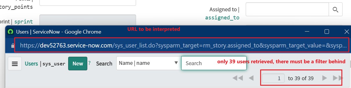

I am trying to interpret the following URL, which is from the navigator when I am trying to find a name in reference field on [rm_story] form, referencing to table [sys_user] (please refer to attached picture for better explanation):
https://dev52763.service-now.com/sys_user_list.do?sysparm_target=rm_story.assigned_to&sysparm_target...
I am aware that sysparm means to pass variable to Script Include to execute and retrieve results from backend. However, not all variables can be found in table [sys_dictionary]. Is there a method to know how is the [sys_user] filtered in the [rm_story] form?

I tested this link in my pdi, and there are no effects of the parameter on the list coming up. Basically the link is the same as
Do confirm though if you are seeing the same results when you are loading both links.
