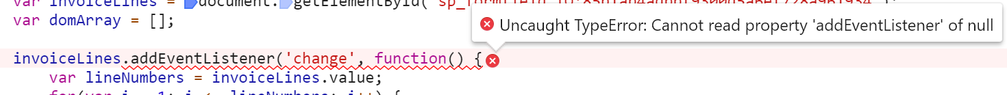

I have a UI script that I have made available to an application portal. The issue that I'm facing currently is that the UI script code is being loaded before the entire dom is ready. As a result, any reference to a dom element in the script would give me the following,
How can I load the code in the UI Script after the entire dom is ready?
