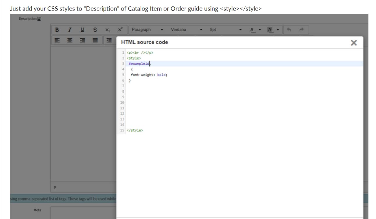

Hi Mark,
Yes sure.
<p><br /></p>
<style>
font-weight: bold;
</style>
added this code under label source code. But it is not reflecting on Service Portal. Code attached for reference. Please suggest on this.
