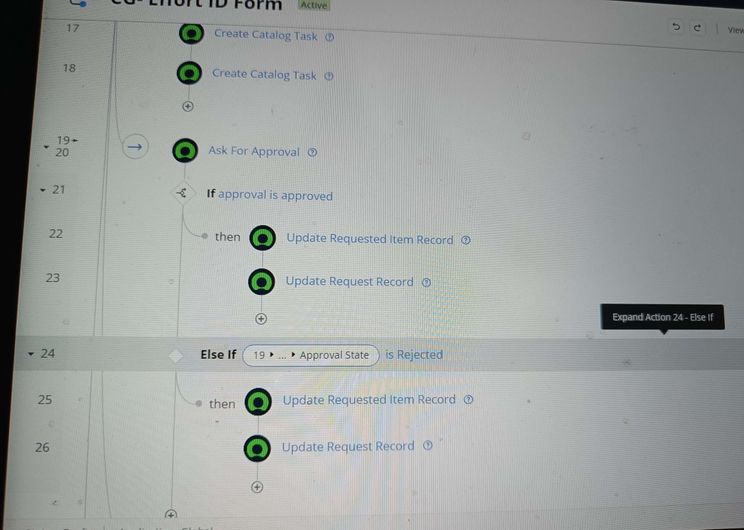

Hello Everyone,
I have requirement to mark task closed incomplete when approver reject.
how can I do it using flow designer.
Attached screenshot of the flow please check, after 26th step of rejection I need to add step to update close incomplete to the task.

vermaamit16
Hi @Vinod S Patil
You can make use of Update Record action with table as sc_task and mark the field State as Closed Incomplete.
