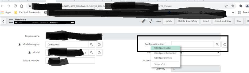

Hi There,
There is cmdb_ci table and class is compute and I took any random record and as per screenshots there is name field value. You can see that. so that value I want to populate on hardware table there is configuration item reference field there I need to populate. I have existing BR and I checked there is need to do some change but I did it but it's not working please help me on this. I have provided the script below
below script

‎03-18-2022 03:07 AM
Do you have a CI with the same name? Example:lw5rq53j3? Can you show the CI record for the same
The reason why your changes aren't working is because you're giving a string 'lw5rq53j3' to a reference field which wants a Sys id.
Hope this helps
Please mark my answer as Correct/Helpful based on impact
Dan H
‎03-18-2022 03:22 AM
If I search 'lw5rq53j3' in the configuration item field I am able to see that but I don't want to do it manually I want auto populate
