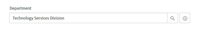

I have a reference field "department" in record producer, I also have the same reference field "department" in my customized table. I need to copy the value of my reference field to my customized table so I mapped the field value. However, it doesn't copy, the value, the field is empty in the table.
It has value in the record producer:
But empty in the Customized table:
