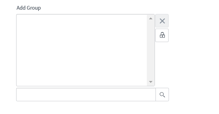

I need to create a variable as a list collector using glide_list attribute with user table as reference. Is there any way to reduce the size of the box appearing when we click the lock using a script? Any help would be greatly appreciated.

Hi Rajalakshmi,
Put that variable in a container start and end
also have your catalog item layout as 2 columns

Hi Ankur,
Thanks a lot. It looks much better now when I used the two column layout.

Hi
Use Container start & Container end variables between your List collector field
