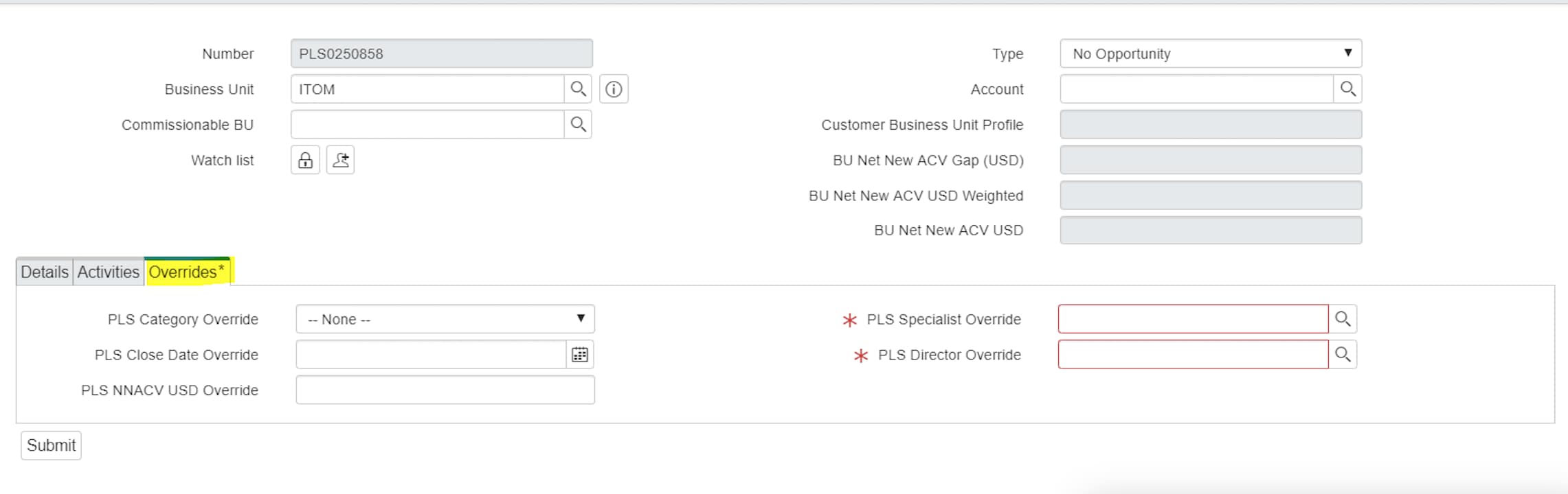

How to remove the asterisk(mandatory) mark for form section field?
Rajesh98
Can you please remove the asterisk mark for highlighted(yellow colour) field?

The * mark is showing because you have a mandatory fields on that section. hence it is displaying and it indicates that this section has mandatory fields

Hi Harish,
How to remove mandatory for form section? i don't want to remove the mandatory for the fields on that section but need to remove the mandatory symbol for form section?

Hi Rajesh,
Refer below link, find appropriate method to hide the asterisk from tab Section:
https://community.servicenow.com/community?id=community_blog&sys_id=01ccee25dbd0dbc01dcaf3231f9619dc

You can use g_tabs2Sections.markAllTabsOK();
Courtesy https://snowpudding.wordpress.com/2014/10/02/demystifying-form-tabs/
