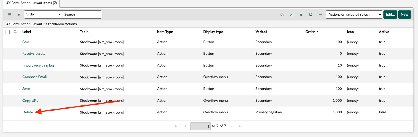

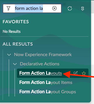

Dinesh Chilaka
@Shiv Choudhary ,
1.In the all navigator search for  form action layouts , try to open that module
2.Search for the record which is having name as Stockroom Actions and open that record
3.There is a related list called UX Form Action Layout Items ,there you can find the record Delete and try to inactivate that record instead of deleting.

Shiv Choudhary
@Dinesh Chilaka
Hi Dinesh,
Thank you very much for your detailed response to my community post. I truly appreciate the time and effort you took to explain the solution and provide the screenshots, which made it much easier to understand and follow.
Your guidance was extremely helpful, and I am grateful for the support you provided. Thanks again for sharing your expertise with the community.
Really appreciate your valuable input and assistance.
Thanks ,
Shiv Choudhary
