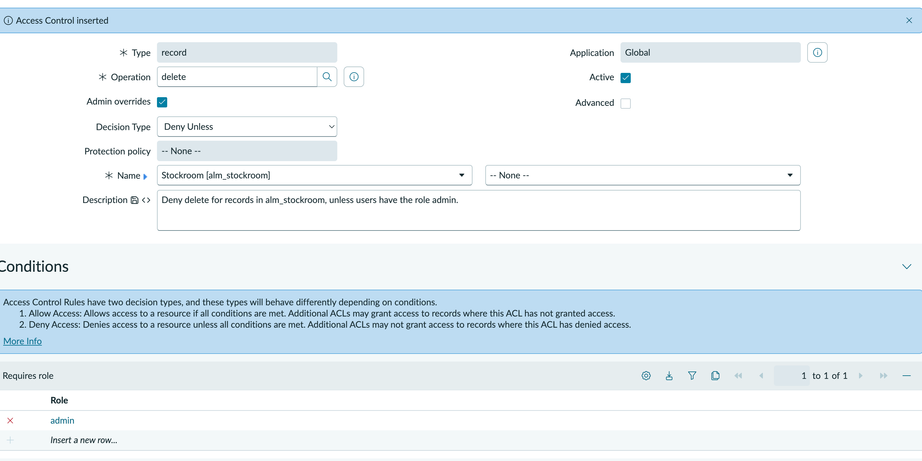

08-19-2026 01:15 PM
I have a requirement to restrict Inventory Admin users from deleting Stockroom records.
Currently, I made the UI Action/Button unavailable, which removes the Delete button from the Stockroom form. However, this hides the Delete option for all users, including administrators.
My requirement is a bit different:
- Users with the Inventory Admin role should not be able to delete Stockroom records.
- Other authorized users (such as system administrators) should still retain the ability to delete Stockroom records if required.
Could you please suggest the best approach to achieve this? Should this be handled through a UI Action condition, ACL, Business Rule, or any other recommended method?
Any guidance or best practices would be greatly appreciated.
Thanks in advance!
08-24-2026 05:41 AM
Hi @Shiv Choudhary ,
Instead of hiding the Delete button for all users, I would recommend creating an ACL to meet this requirement.
Out of the box, there are already two Allow If ACLs that grant users with the inventory_admin role access to delete Stockroom records. I would not recommend modifying these existing ACLs. Instead, create a new Deny Unless ACL with the admin role.
This will ensure that Stockroom records can be deleted only when the logged-in user has the admin role.
If my response helps, mark it as helpful and accept the solution.
Dinesh.
