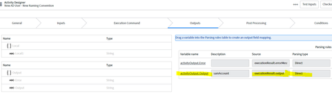

I need 1 help. I do have Powershell Script to create Active Directory account, so I create 'activity designer' and embed the Powershell script there. The output is set as 'Direct'.

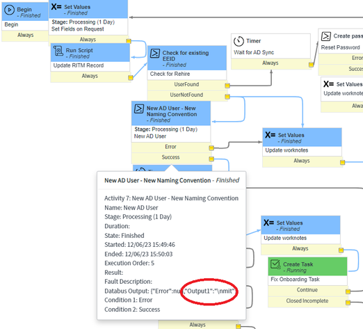

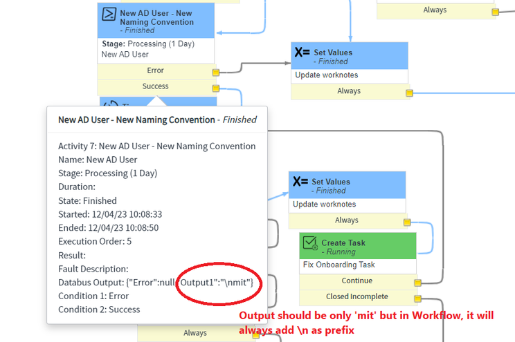

So far, the Powershell Script works well, it could create Active Directory account but I faced the Output in that activity designer, it will always add '\n' as prefix so like below captured screen, the script could create Active Directory account: 'mit' but the Output will show as '\nmit'.
I will really need this output to be the input of the next activity, so it will be failed because of '\n' prefix.

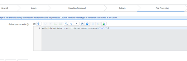

Is it possible if I choose option A to add output post processing script? I tried below one but still get the '\n' as prefix.
12-05-2023 11:31 PM
@Bird1 Have you tried the "\\n".
activityOutput.Output = activityOutput.Output.replaceAll("\\n", "");
Anvesh
12-06-2023 01:00 AM
I've tried to update to activityOutput.Output = activityOutput.Output.replaceAll("\\n",""); but still get '\n' prefix.
