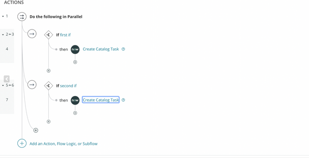

Hi @Community Alums
To achieve this you can use "Do the following in parallel" action in your flow. Please find below snapshot for your reference. And then add your next steps

Subhashis Ratna
Hi @Community Alums
Use a Parallel flow logic and structure it like this
For Ref :

Hi @Krushna R Birla ,
If I use the wait for condition using do the following in parallel. Then, again it will wait at the first task, till the condition is satisfied. Later, It will go to the next task.
To trigger the tasks in parallel. I have unchecked the "wait" in the task but if I use the "Wait for condition" then again it will wait, at the task 1 and the tasks will become serial.
@Subhashis Ratna , If I have 2 parallel tasks I can use this logic. But the number of parallel tasks are not fixed. It can be "N" number.
