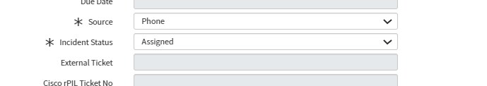

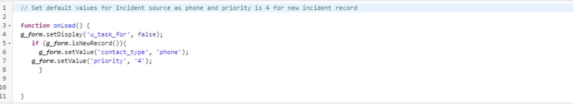

Need your help here. Actually there is a task to make a dropdown value none which now showing phone(source field). I checked it by going to source field- configure dictionary- choice list specification - value ---> in value field nothing is showing there. it is blank. So i checked client script which is as below.

We are at ITSM/TOP/GBP/ABC domain but this client script is written at ITSM/TOP/GBP domain.
So how can i now change the source field choice field from phone to -none-.
if will change this client script /deactivate which is at GBP domain , don't know where it will effect.

Client script can be overridden in the child domain. That is, create a new client script in ITSM/TOP/GBP/ABC domain that does nothing.
function onLoad() {
Then, check  "Inherited" checkbox. If "Inherited" in not on the client script page,  add it to the page.
https://support.servicenow.com/kb?id=kb_article_view&sysparm_article=KB0963141

i did the same , created a new client script as below but same source field is updating over the incident table. none is not coming there , instead phone is coming.
