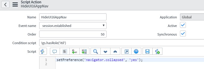

What I'd recommend is doing a script action.
Set it to event 'session.established'. There will be a checkbox called synchronous on that table which you check (it might need adding to the form and also have an acl against it which you'll need to set to admin overrides true).
Then on the script, just have:
if (!gs.hasRole('itil')) {
  gs.setPreference('navigator.collapsed', 'yes');
That will set their preference on log in and then the page will be loaded
(slight disclaimer, I haven't checked if that preference is the right preference or not, but the code above is the concept for setting it on login - heres an example of setting another property that way Reverting The 'Modern Cell Coloring' Back to Pre-Eureka | Service Now Gems )

Like this Ahmed?
yeah, except gs.setPreference not just setPreference.
setPreference is the client script wrapper for gs.setPreference
