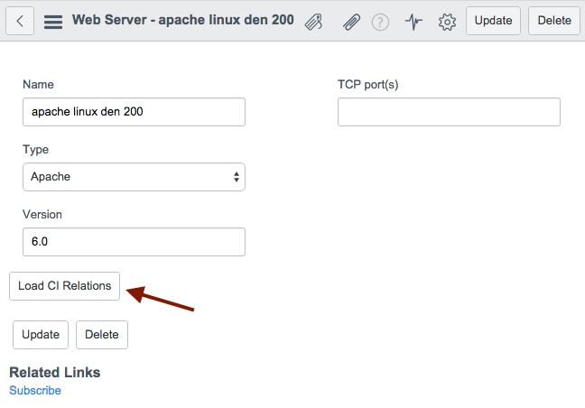

Then you will see a form like this:

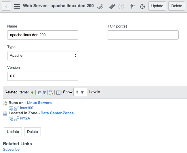

And when you click on that button... shazam...
Not a perfect solution, but you should be able to make it work reasonably well.

will_leingang
Hi Sachin, I think GT is providing 2 different solutions in his answer - giving you some choices.
I spent quite a bit of time researching this for you and there is actually no way to put the ci relationship element in a popup or to load it after the form context. The way that it's built requires global jelly variables from GlideContext that can't be recreated in another context. so... here are a couple of alternatives.
