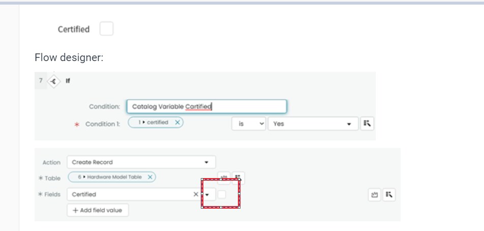

I have a requirement to create few fields in Hardware Model table. Most of the records got created except one field i.e. certified field, as because the the field mentioned in the catalog form is Yes/No field and in the table it is a Check box.
Field in Catalog form:
Field in Hardware table:
Flow designer:
But field is not getting updated.
Kindly suggest.
Thanks in advance.

01-16-2022 05:30 AM
You need to mark the check box as True which is next to Certified as shown in screenshot below:
Shloke
01-16-2022 05:24 AM
You can use inline script to update the value to true/false, since the variable and field on table are of different type.

Hi Shloke,
Thanks for your reply.
It's working properly now.
