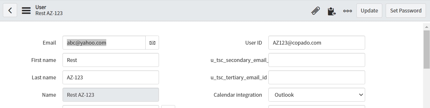

Hello Developers,
I have been trying to update to update userid which is on user table for 1000+records,
It is not taking correct format, I guess there is something wrong in the script.
I want to update userid as 'AZ123@company.com' , Could anyone suggest where should i make changes in the fix script so that script will successfully update the records that we have in our system,
I am using below script, for updating records via fix script
Fix Script:
var gr = new GlideRecord('sys_user');
gr.addQuery('sys_domain', '');
gr.addQuery('first_name', 'Rest');
var ans = desc.match(/([A-Z][A-Z]|[a-z][a-z])-[0-9][0-9][0-9]|/gi);
gr.addQuery('last_name', ans);
gr.query();
if (gr.next())
var str = gr.user_name;
var res = str.replace('-', '');
var res = str.concat('@company.com');
gr.user_name = res;
gr.setWorkflow(false);
gr.update();
Any kind of help is highly appreciated here,
Thanks & Regards,
Ujjwala
‎10-13-2022 07:01 AM - edited ‎10-13-2022 07:14 AM
Hi @Ujjwala1 ,
can you try this script. if loop will not work for bulk update
gr.query();
while (gr.next()) {
var res1 = res.concat('@company.com');
gr.user_name = res1;
gr.update();
‎10-13-2022 07:00 AM
Hi Ujjwala1
You want to update username in what format?Can you explain in detail of your requirement with few sample examples?

‎10-13-2022 07:02 AM
Hi @Ujjwala1
What I understand from your requirement is that you just want to remove '-' hyphen from your user ID, right?
Else can you give sample if this is not right?
