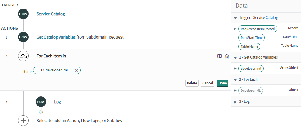

My bad. With Paris, it's mrvs can now be accessed using "Get Catalog Variables" as with any other variables. mrvs is retrieved as an Array.Object that may be looped with "For Each Item" step.
Example. "developer_ml" is a mrvs.
Looping through records in mrvs
Logging out of a record
