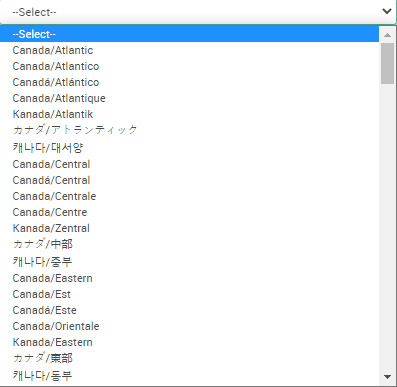

I have a variable that displays time zone for the user to select but I want only the choices whose language is English (en) to be displayed.
How can I achieve that? My variable page does not have the reference qualifier option. How to filter choices based on language?

I would suggest you to change it the variable to lookup select box then you will be able to apply reference qualifier.
Please mark answer correct/helpful based on Impact.
01-25-2022 04:59 AM
you cannot add ref qualifier to drop down variable
Make it lookup select box which refers to that table
OR
discuss with your customer on the requirement
