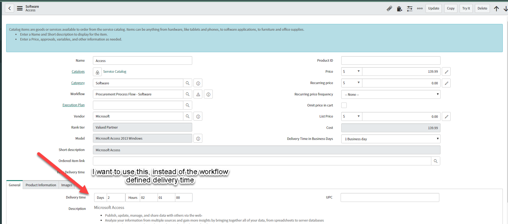

Note: I'm the new guy, trying to learn some ServiceNow development 🙂
I'm trying to figure out how, to use the already presented delivery time on sc_cat_item to define the delivery time shown on the service portal. I have figured out that the delivery time shown on the service portal comes from the workflow properties, the item uses.
The thing is, we / my company have hundreds of items using the same workflow, and i would really like to differentiate between the delivery time of these.
How can that be done?
