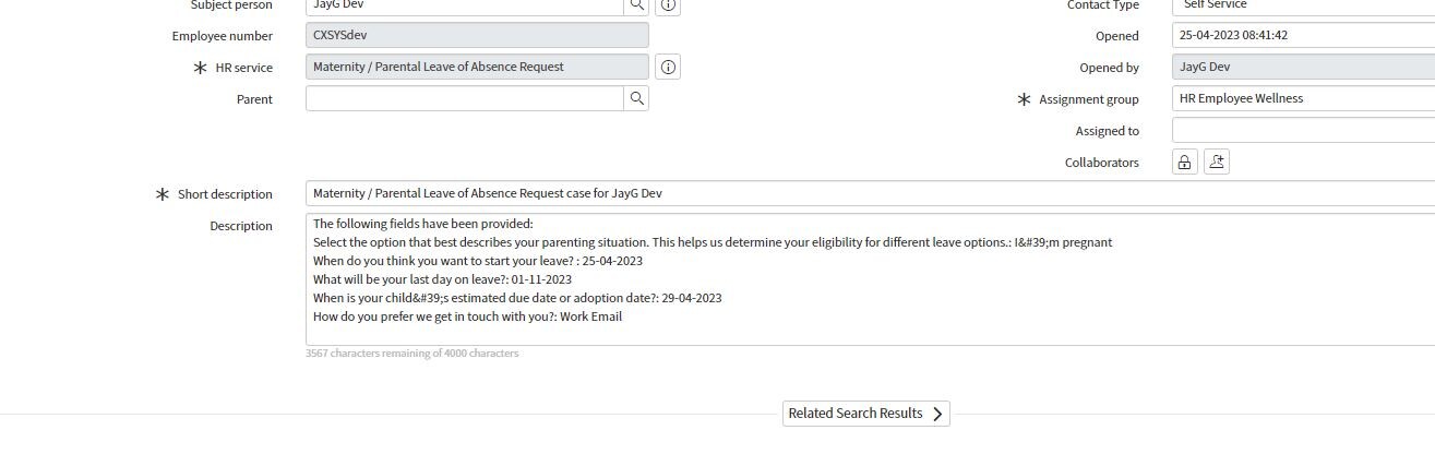

We are in the process of upgrading to Utah. During our testing, we have had an issue with how the description field is being formatted on HR Cases.
We are using the rich_description field on HR Cases, but there are different formatting issues occurring on both the description and rich_description fields.
In the description field, apostrophes are showing as "'".
In the rich_description field, there are no line breaks being added, so the ticket details end up just looking like a big text block.
Do you have any idea what might be causing this or where to find where this is being formatted? I have looked through business rules and script includes to try and find where this occurring but have not had any luck.
