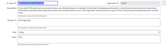

Setting the System Property glide.ui.html.editor.contextmenu to false seems to disable the editor’s contextmenu for some fields. However, we are mainly using the Rich Text Editor for Comments and Work Notes in the Configurable Workspace and are sending a lot of emails via the email client. I cannot figure out how to disable it for these specific fields.
Does anybody knows, has any news or a hint on how to disable the context menu for these as well (preferably without using custom scrip)?
