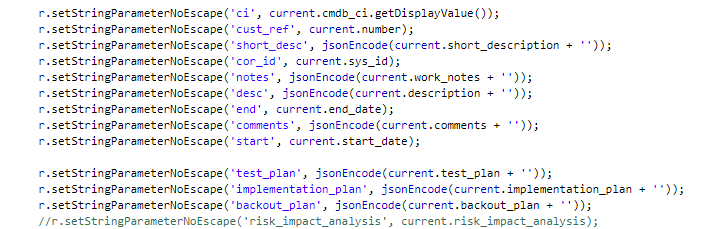

Hi Jaheer thanks for the response. The below is the business rule with the code, all other fields are working fine.
@CandyDee Can you please post the jsonEncode function as well?

@CandyDee As implementation plan is a html field it return the html string not the object. So instead of passing it to jsonEncode function. use the script below to extract text from html string.
var implementationPlan = current.implementation_plan+'';
implementationPlan = implementationPlan.replace(/<\/?[^>]+(>|$)/g, "");
//Send this in the API setStringParameter function
Please mark as correct answer if this solves your issue.
