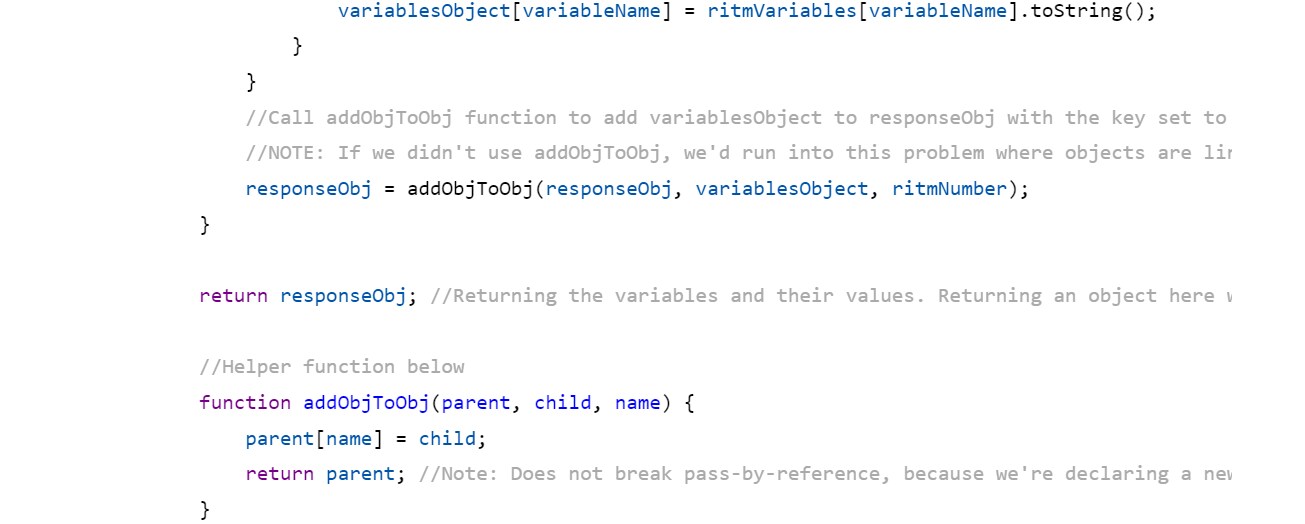

If you are trying to hit a TABLE level API , you will be getting response configured OOB. But what I am understanding from your use case is you have a custom endpoint and through which you are trying to create record by hitting that API in target instance.
So in order to send a response back to your source system you need to configure it in your Scripted Rest API so that when a record gets created Scripted Rest API send it back to your source instance as shown below:

Example screenshot attached below to look the way response is getting sent:

you can created one scripted rest api in another instance and get that url
and use that url as end point for your instance
you can modify request and response body as your own requirnment
