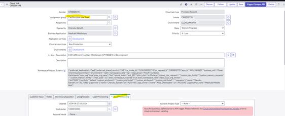

I want to hide Cloud_ provisioning tab in CAAS request
JVINAY
Hi Team,
I am Writing below code for Hide Two fields And also apply one filter for Cloud provisioning tab visible in Design CIT's.
function onLoad() {
    var env = g_form.getValue("u_environment");
    var cloudTaskType = g_form.getValue('u_cloud_task_type');
    var isProvisionTask = cloudTaskType === 'provision';
    if (isProvisionTask) {
        alert("sample");
        var ga = new GlideAjax("CloudClientUtils");
        ga.addParam("sysparm_name", "validateEnv");
        ga.addParam("sysparm_env", env);
        ga.getXML(validateEnv);
    function validateEnv(response) {
        alert(answer);
        if (answer == "true") {
            g_form.setMandatory('u_environment.u_additional_fields_record.u_comment_for_olympus_review', true);
            g_form.setDisplay('u_environment.u_additional_fields_record.u_requires_olympus_review', true);
            g_form.setDisplay('u_environment.u_additional_fields_record.u_comment_for_olympus_review', true);
        } else {
            g_form.setMandatory('u_environment.u_additional_fields_record.u_comment_for_olympus_review', false);
            g_form.setDisplay('u_environment.u_additional_fields_record.u_requires_olympus_review', false);
            g_form.setDisplay('u_environment.u_additional_fields_record.u_comment_for_olympus_review', false);
But the issue is cloud Provisioning tab visible in CAAS requests, but I want to hide cloud Provisioning tab in CAAS requests,
This scenario I want to add one more filter .
Please help how to achieve these .
for above is CAAS request,  I have marked Cloud Provisioning tab, these should not be Visible in Caas requests..
Requirement : I want to hide Cloud_ provisioning tab in CAAS request

Hi @AniketC85155510 ,
Thanks for your comment, but above code not working still Cloud provisioning tab visible under the CAAS requests.
