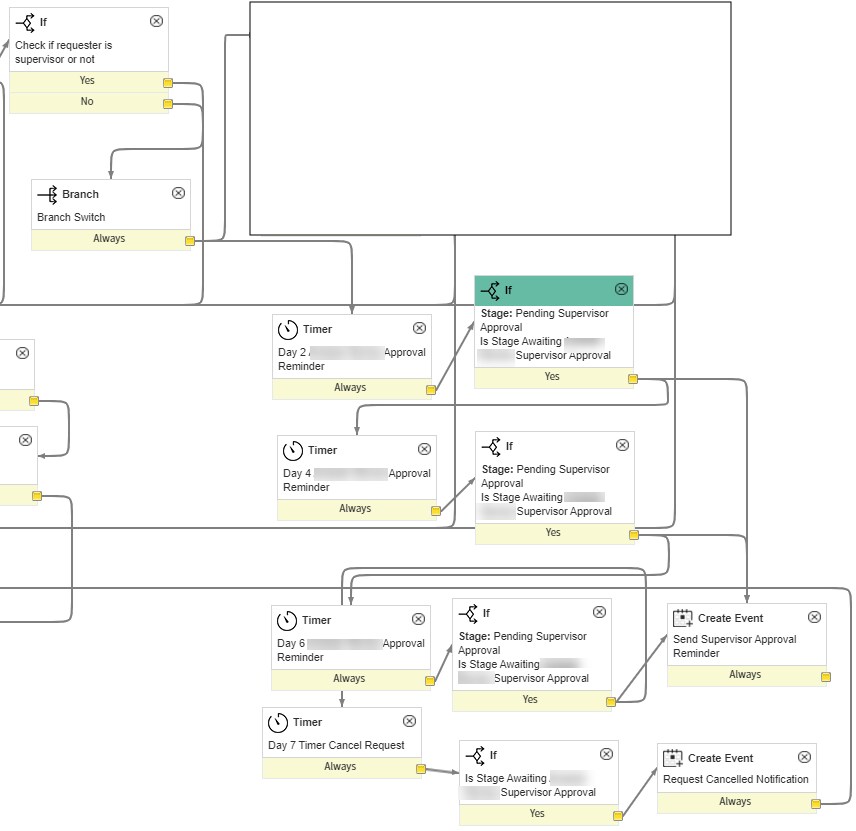

Thank you for the information.  I continued down the path of utilizing a Create Event in my workflow.  It finished the Timer, the If, and Create Event activities but wasn't sending the notification.  After viewing the Events log, I finally figured out that I needed to set the Parameter 1 value in the Create Event activity with my approver information. My notifications are now being sent.

Lisa_Wiegmann
Hi Tejaswini,
I did the following:
1. I created 3 timers in the workflow (they wanted a reminder sent every two days).  Each leads to an If action that evaluates if the Stage is in a pending state.  If it is, it leads to the Create Event.
2. Here is a screeshot of the Create Event.
3. Create an Event Registry for the Event name you created in #2.  Table = Approval [sysapproval_approver] and the Fired by is the name = <name of your workflow>.
4. Create a System Notification.
For the "What it will contain.  I always like to start with minimal information.  After I've confirmed the email is being sent, I add in the rest of the information.
Maybe there is an easier way, but this works for us.
Good luck!
