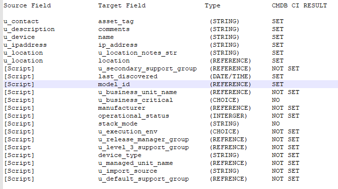

I've been trying to figure out why my import set / transform map with IRE enabled (Identification and Reconciliation) is only working to some degree when it comes to updating/creating a configuration item.
My transform map has a number of mapped fields and only some of them will update the target fields on the corresponding CI. (or populate those fields on a new CI)

 Here's a summary of the transform map itself including the resulting CI's fields when it would find / update an existing CI.

The transform map fields using a source script are all pretty basic.  Here are two examples of fields that won't update / populate if a new created CI.
such as with the Device Type source
answer = 'Network Hardware';
or  u_level_3_support_group
if (source.u_contact == 'Middleware ADC'  || source.u_contact == 'Middleware ADC') {
    answer = '188550470f090280b6cd00dce1050e8b';  // Level 3 ABC
} else {
    answer = 'aaeac510077142001aa6e388b1050ed9';  // Level 3 BBB
I just don't understand why it seems to populate/update some of the fields defined in the transform map but not all.
The logs aren't giving me anything.
Any ideas?
