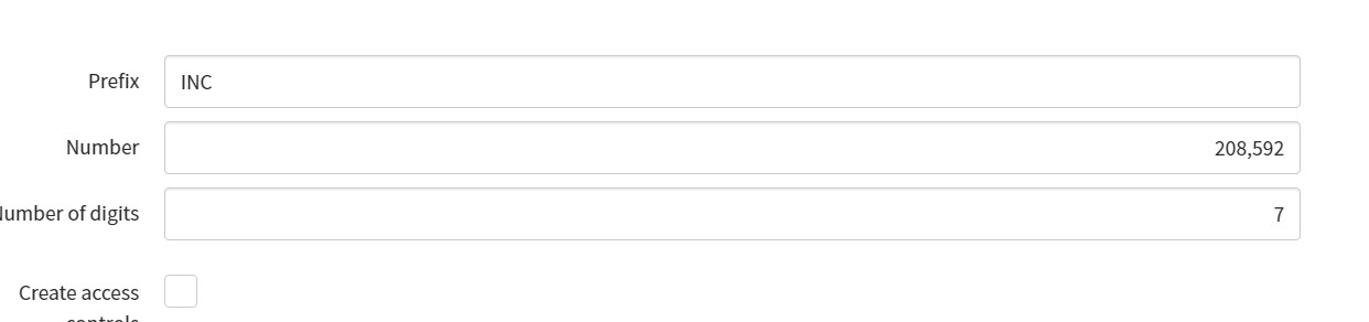

ā02-23-2022 02:57 AM
Please go the system definition> tables> incident
Under control tab, you can change the prefix as well as the number from 7 to 8.
https://YOURINSTANCEID.service-now.com/sys_db_object.do?sys_id=incident&sysparm_refkey=name
Sandeep
