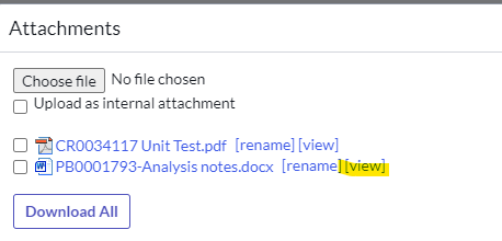

Hi folks,
I am trying to change the URL in the Attachment [View] link which is constructed in UI Macro [attachment_entry], and have not found a way as it has not been visible for the modification.
A little bit background to explain why I am trying to do so: In my organisation, old attachments (let's say 90 days old) are archived and exported to a remote cloud storage called MS Azure, When a file is archived (uploaded to Azure) users still can access the attachments but the download process triggers a restoration process in the backend. This works perfectly fine when they click the Filename in the attachment list, but when clicking the [View] link, the Document Viewer would not be able to fetch the file, as technically this file no longer exists in system as sys_attachment record,
To overcome this issue, there is a custom Processer named u_sys_attachment_ext.do, instead of the OOB sys_attachment.do. The custom process checks to see if the file is archived, if so, performs a restoration process and presents the attachments to the end user.
My goal is to make a change to the OOB URL from "sys_attachment.do?sysparm_referring_url=tear_off&view=true&sys_id=5cb12527db781190404ba6bad396197d"
to
u_sys_attachment_ext.do?sysparm_referring_url=tear_off&view=true&sys_id=5cb12527db781190404ba6bad396197d
However, the UI macro tearOffAttachment function does not seem editable to me?
<a class="attachment view_${sys_attachment.sys_id}" click-on-enter="true" href="#" onclick="tearOffAttachment('${sys_attachment.sys_id}');" aria-label="${HTML:jvar_attachment_aria_label}">
${jvar_attachment_action_title}
</a>
Thank you for your attention and advice
